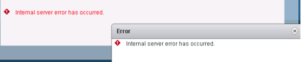

When viewing logical switches in the vSphere Web Client, you experience these symptoms:
  • The vSphere Web Client displays the error:
    Internal Server error has occurred.
  • Only some ​of the logical switches are impacted and you are not able to manage the Logical switches impacted from the vSphere Web client.
