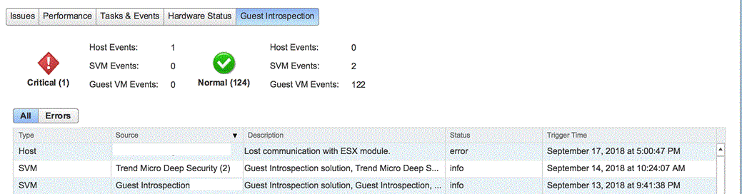

  • When Mux is not able to get health stats timely due to host being busy working on VM operations like vMotion / power on and off / new VMs bring up, you might see the error on vsphere UI “Lost Communication with ESX module” as shown:
