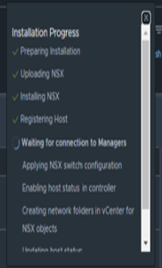

Installing NSX on a transport Node fails at 48% with "Failed to install software on host. Failed to install software on host. Time out waiting for host to join NSX Manager."
