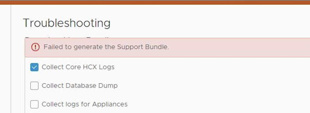

HCX Manager UI >> Administration >> Troubleshooting >> Collect Core HCX Logs
) from the regular HCX Manager UI (https://<HCX_manager_IP>:443) a "Failed to generate the Support Bundle." error is seen in the UI .
