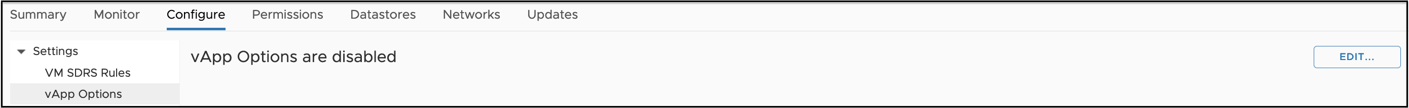

1. Check OVF section of the VM.
a. Enable vAPP Options:
Go to VM >> Configure >> vApp Options >> Edit vApp Options >> Enable vApp Options
