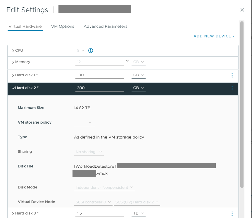

  • When viewing the VLCR Connector appliance configuration, the vmdk of the failed snapshot protected Virtual machine is mounted as an Hard disk.
