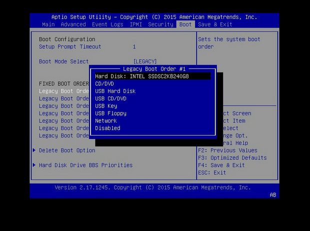

840
Enter BIOS by pressing the Del key when prompted during rebooting.
Disable booting from USB
  1. Move the Left/Right arrow key to Boot
  2. Move the Up/Down arrow key to Boot Mode Select
  3. Press ENTER
  1. Move the Left/Right arrow key to LEGACY
  2. Press ENTER
  3. Move the Left/Right arrow key to Legacy Boot Order #1
  4. Press ENTER
  5. Move the Up/Down arrow key to Hard Disk: …
  1. Press ENTER
  2. Move the Left/Right arrow key to Legacy Boot Order #2
  3. Press ENTER
  4. Move the Up/Down arrow key to Disabled
  1. Press ENTER
  2. Repeat the above steps for all Legacy Boot Orders other than #1  to disable booting

2000
  2. Move the Up/Down arrow key to Boot Mode Select.  Skip steps 2 to 5 if it’s already set to LEGACY (Default)
  3. Press ENTER
  4. Move the Left/Right arrow key to LEGACY
  5. Press ENTER
  6. Move the Left/Right arrow key to Legacy Boot Order #1
  7. Press ENTER
  8. Move the Up/Down arrow key to Hard Disk: …
  1. Press ENTER
  3. Press ENTER
  1. Press ENTER
