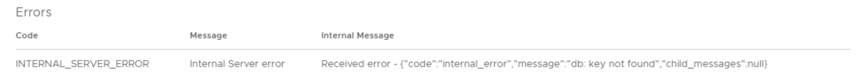

  • Error while trying to delete the Management Cluster from TCA UI
  • Unable to Delete Management Cluster in Telco Cloud Automation UI
  • Failed to delete the management cluster.
  • INTERNAL_SERVER_ERROR    Internal Server error    Received error - {"code":"internal_error","message":"db: key not found","child_messages":null}
