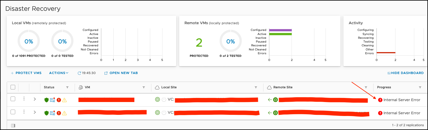

DR protected VM will fail to recover on the target vCenter during Test Recovery or Recovery VM operation, and we can see following error on the target HCX-DR wizard.
Below logs can be seen in HCX app-engine logs during the time of failure:

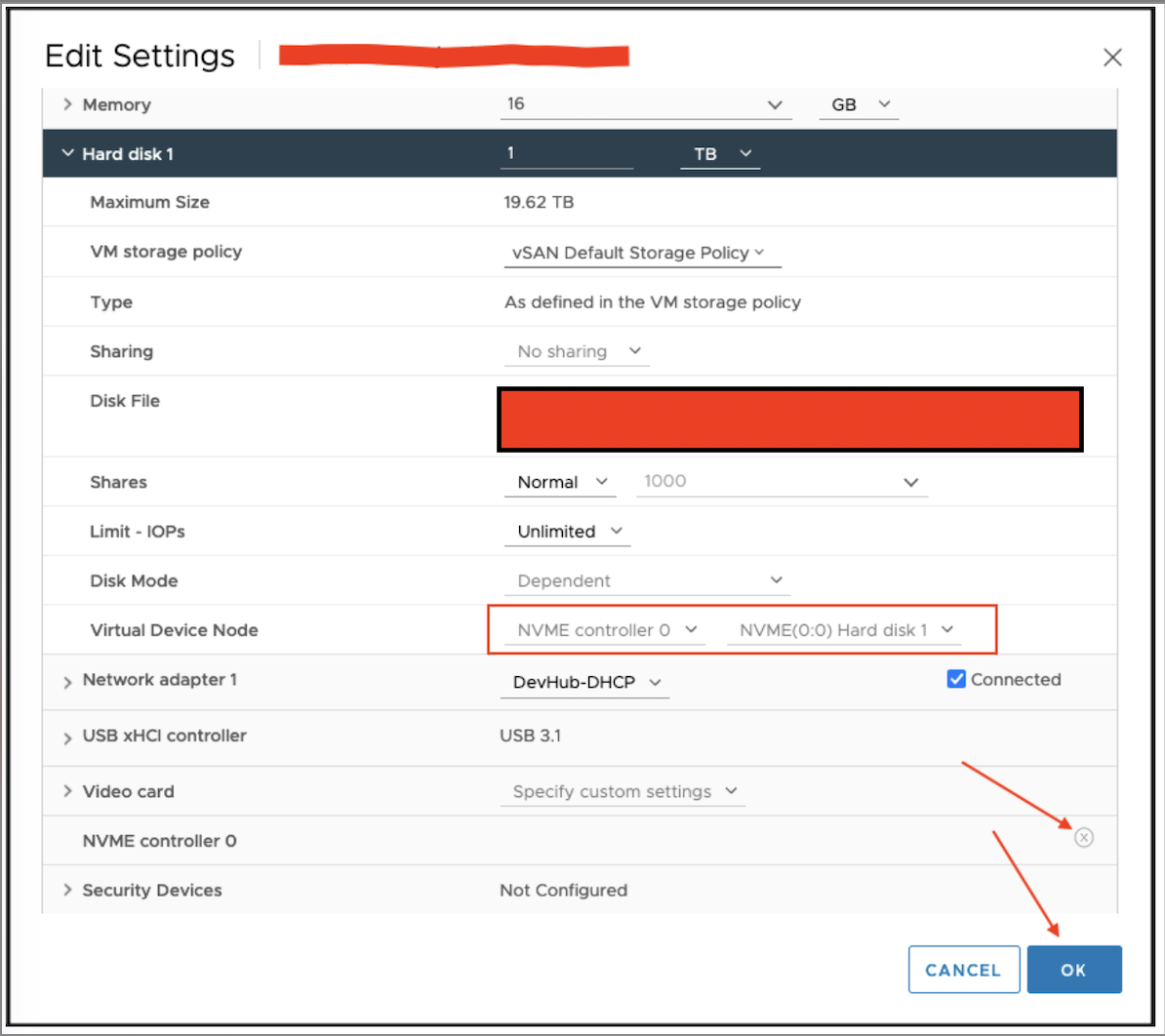

Customer is advised to modify Virtual Device Node setting back to SCSI controller to unblock DR protections and migration workflows.
STEP:1 Power off the VM
GO to Source vCenter UI >> VM >> Actions >> Power >> Power Off
STEP:2 Select SCSI controller
GO to Source vCenter UI >> VM >> Actions >> Edit Settings >> Hard Disk >> Virtual Device Node >> SCSI Controller
STEP:3 Power on the VM
GO to Source vCenter UI >> VM >> Actions >> Power >> Power On
STEP:4 Perform DR protections or Migration
