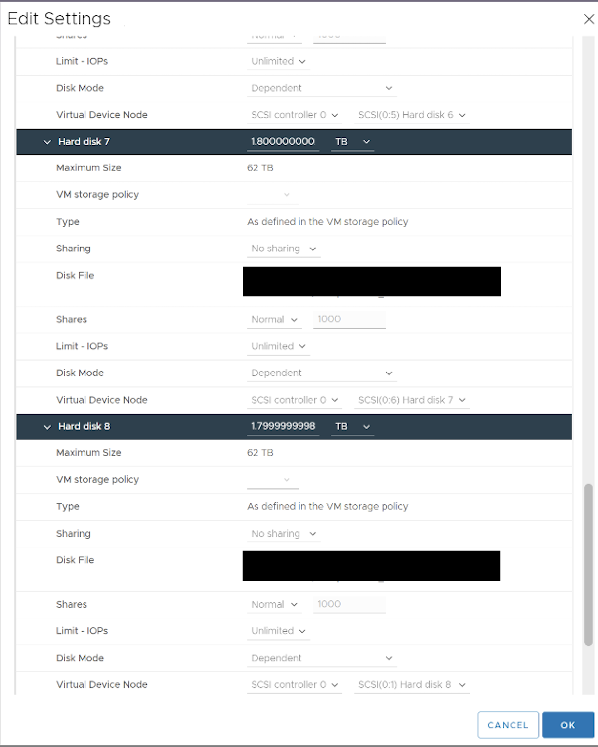

See below example:
Note: the seen UI is cut-off and actually has an appended at the end, integers '558794' at the end being " 1.8100000000558794 TB" these disks 7 and 8 would need to be identified as 8192 bytes.
  1. Select the dropdown and change the disk sizing category from TB --> GB (sizing type) to add an appropriate integer value (without any trailing decimal point values).  In the above example, a value of 1855 GB was used to resolve the issue
  2. Click the "OK" button to save the VM settings
  3. Retry HCX migration validation, and it should pass (log-out and log-in may assist with any unexpected web-browsing caching)

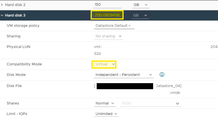

    For RDMS:
    Change the Disk size from the Storage end.
