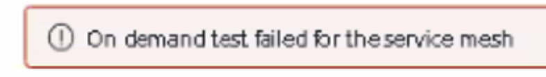

After upgrading HCX Connector or Cloud manager to 4.6.0, the uplink test could be failed with below error:

  • The Uplink test performed through Transport Analytics wizard will be failed for HCX 4.6.0.
Note: This behavior could be noticed in the environments where uplink network is shared with Mgmt/vSR OR vMotion in HCX Network Profile configuration running 4.6.0.
