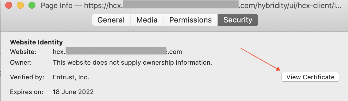

2. Verfiy if thumbprint seen in Extension Manager of vCenter is same as current thumbprint of HCX.
a. Navigate to: https://<<VC-IP>>/mob/?moid=ExtensionManager&doPath=extensionList%5b%22com%2evmware%2ehybridity%22%5d%2eserver
Make a note of "serverThumbprint" value.
b. Grab SHA-1 thumbprint of HCX by hitting URL https://<<HCX-IP>>
Make sure the value of thumbprint of HCX should be same as the one obtained from MOB console.
Go to Site Information tab on the URL:
---> Connection secure
---> More Information
---> Security
---> View Certificate
This shows a mismatch in the value of thumbprint of HCX with the one obtained from MOB console, which results in error downloading plug-in situation with vSphere Web Client.
