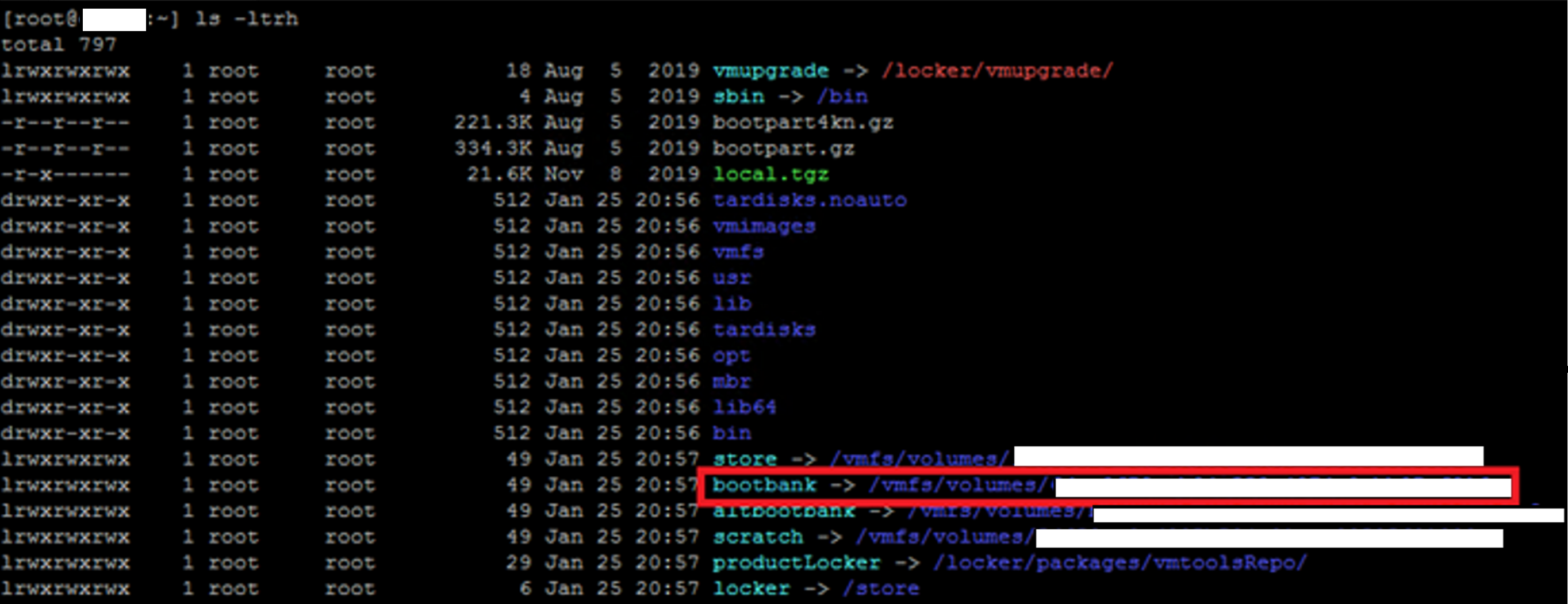

  2. Identify the boot location of the ESXi host by running this command:
    ls -ltrh
  3. Ensure that the symbolic link (symlink) is reflecting in a blue color.
    Note: If the symlink is a red color, this indicates connectivity issues to the underlying device and may not be readable or accessible.

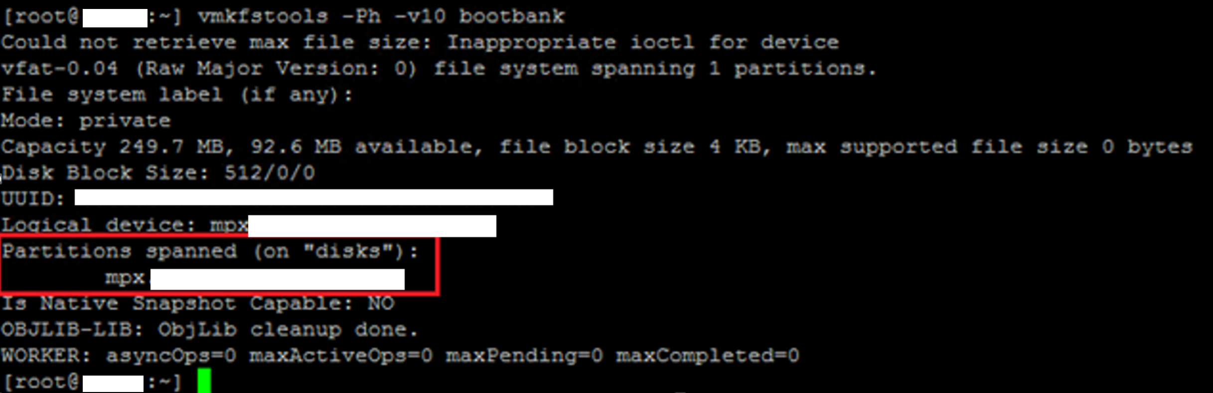

  4. Obtain the device identifier for the Datastore (For example: naa, mpx, eui, vml etc.) to be modified by running this command:
    vmkfstools -Ph -v10 bootbank
    or
    vmkfstools -Ph -v10 /vmfs/volumes/<datastore name>
    For more information, see   Identifying disks when working with VMware ESXi.
    Note
    : The next steps use mpx.vmhbaX:CX:TX:LX as an example. Replace mpx.vmhbaX:CX:TX:LX with your device identifier that may begin differently. For example, naa or eui.
