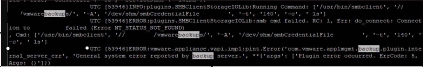

  • The /var/log/vmware/applmgmt/applmgmt.log shows entries similar to the following at the time of the failed backup:
[13051]INFO:plugins.SMBClientStorageIOLib:Running Command: ['/usr/bin/smbclient', '//vcsa-backup/vCenterBackups/', '-A', '/dev/shm/smbCredentialFile1a2b0cde', '-t', '140', '-c', 'cd >VSIvCenterConfiguration/; ls'
[13051]ERROR:plugins.SMBClientStorageIOLib:smb cmd failed. RC: 1, Err: do_connect: Connection to vcsa-backup failed (Error NT_STATUS_NOT_FOUND)
