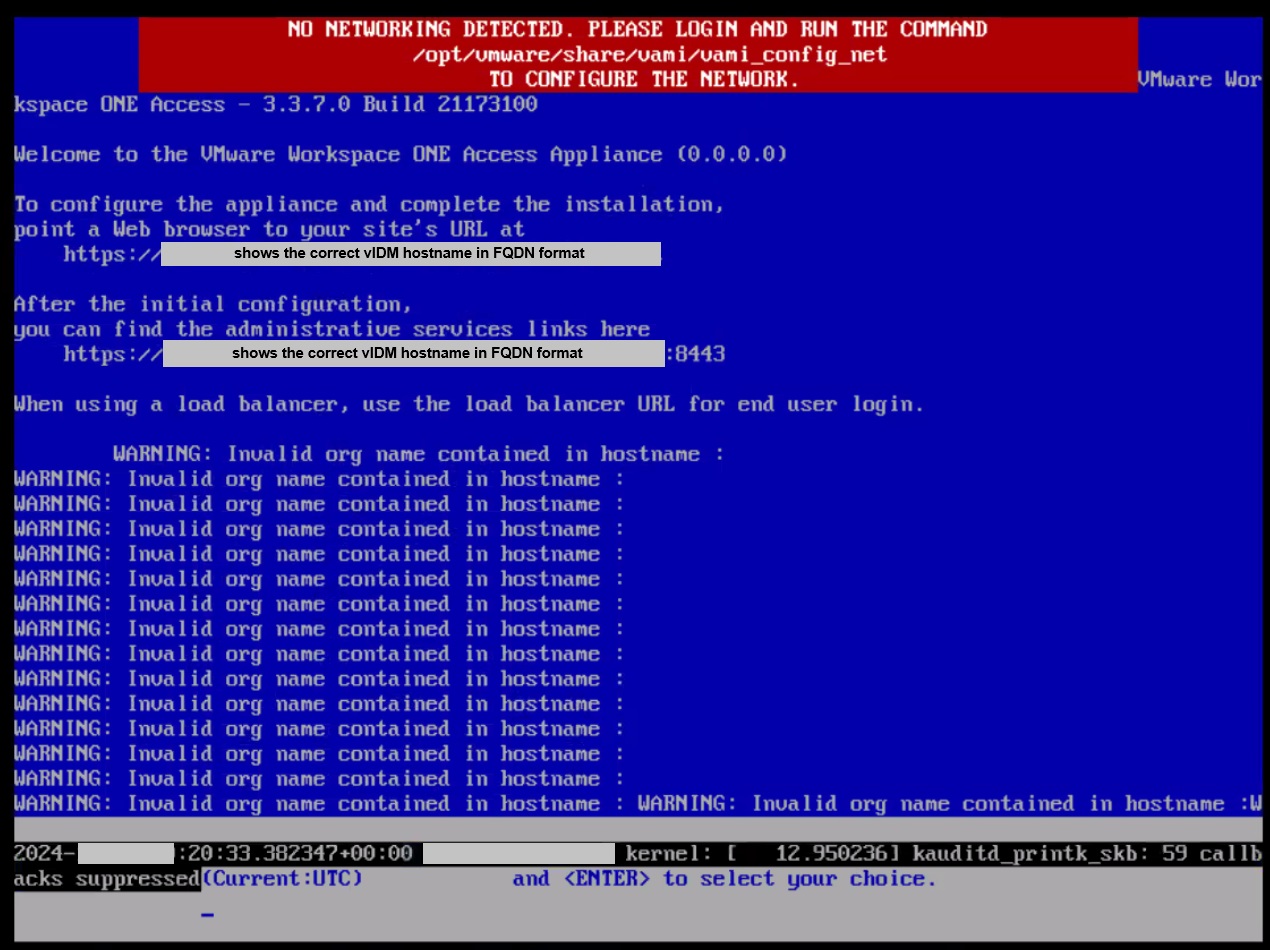

Symptoms:
  • the vIDM (VMware Identity Manager) node is constantly rebooting
  • for a short period of time the blue DCUI interface can be seen however
    • it shows a red banner is displayed stating: "NO NETWORKING DETECTED. PLEASE LOGIN AND RUN THE COMMAND..."
    • the web links shows contain the correct FQDN
    • further a lot of messages can be seen stating: "WARNING: Invalid org name contained in hostname :"
