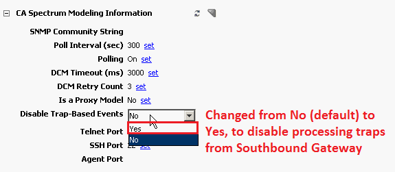

When the Spectrum receives the traps from the snmpgtw probe, the traps are forwarded to both models, because the EventAdmin and NimsoftHostServer/NimsoftVMPingable models have the same IP address.
As the NimsoftHostServer/NimsoftVMPingable model does not have the Southbound Gateway functionality, the 0x10801 event is generated (Unknown alert received from device)
Set the “Disable Trap-Based Events” option under ‘CA Spectrum Modeling Information’ subview of NimsoftHost/NimsoftVMPingable model to Yes.
