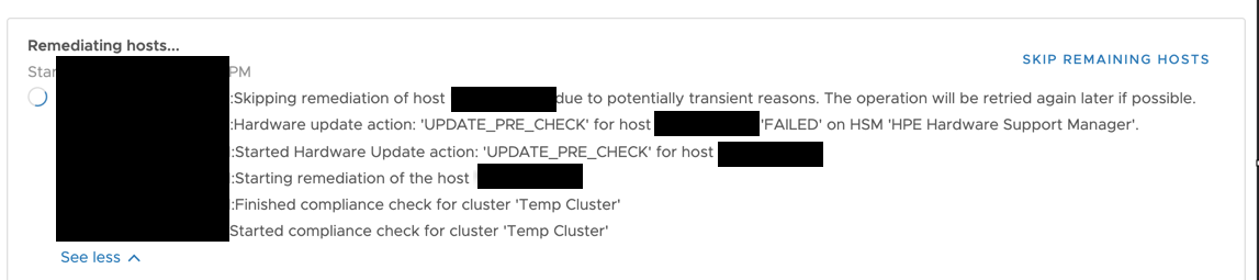

Systems using vSphere Lifecycle Manager (vLCM) to manage ESXi, vendor add-on components, and firmware may encounter the following error when upgrading.
This occurs during the remediation pre-check, vLCM detects that the service required to stage and deploy updates and reboot the server (iSUT) is either not running or not set to Auto Deploy.

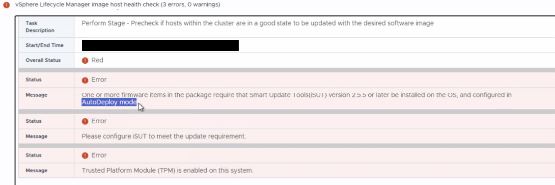

  • Error: “Skipping remediation of host due to potentially transient reasons.”
  • One or more firmware items in the package require that Smart Update Tools(iSUT) version 2.5.5 or later be installed on the OS, and configured in AutoDeploy mode

The HPE HSM reports an error if the minimum required version of iSUT (2.5.5) is not installed, or if iSUT is not configured in Auto mode. In Auto iSUT mode, the service responsible for staging and deploying firmware updates and rebooting the server must be running and set to AutoDeploy.
Ensure the iSUT service is set to AutoDeploy on the ESXi,
  1. Log in to ESXi host.
  2. Set the iSUT mode to AutoDeploy Mode
    sut -set mode=AutoDeploy
  3. To view how iSUT is current configured:
    sut -exportconfig
  4.  To check what version is installed you can run:
          sut -version
