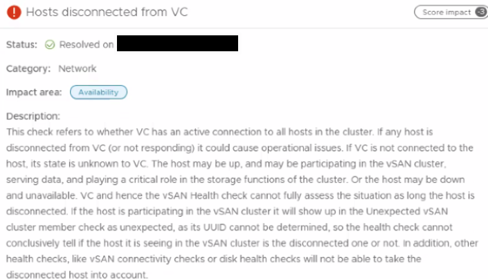

  • If the affected ESXi host is part of a vSAN cluster, Skyline Health (Cluster > Monitor > Skyline Health) may display the alert 'Hosts disconnected from VC'
