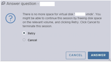

  • Powering on VM gives below error:
    There is no more space for virtual disk <VM.vmdk>. You might be able to continue this session by freeing disk space on the relevant volume, and clicking Retry. Click Cancel to terminate this session.
