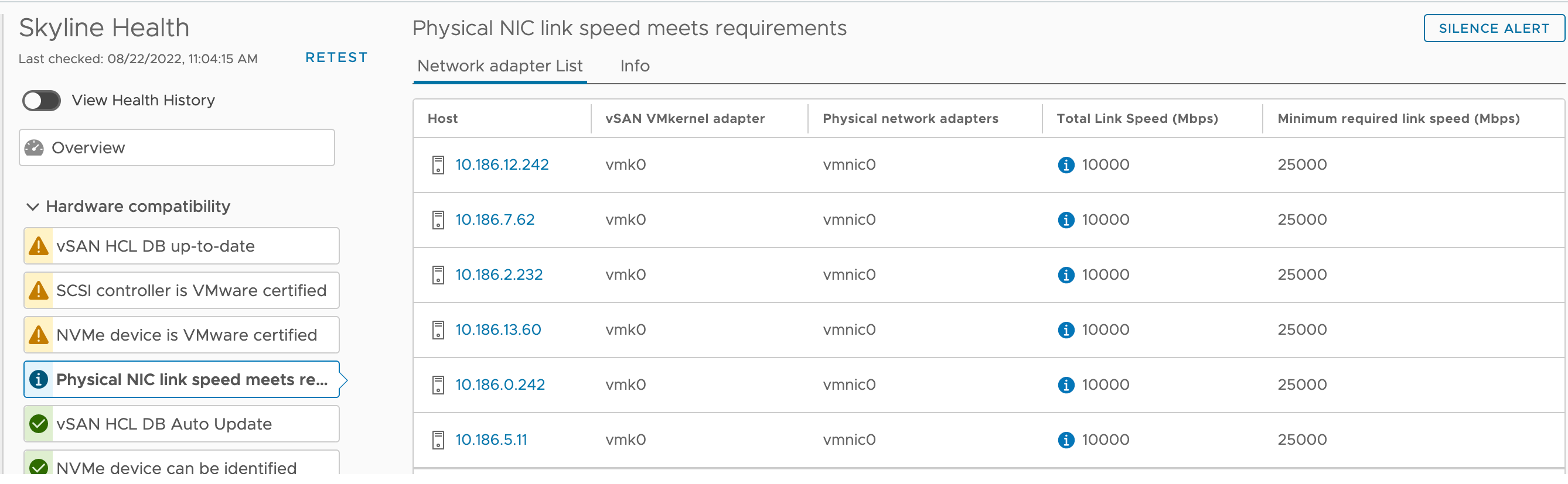

Q: What does the Hardware Compatibility - Physical NIC link speed meets requirements check do?
vSAN ESA recommends a minimum aggregated network link of 25Gbps (reduced to 10Gbps for vSAN 8.0 U3 and higher).
You can consider multiple NICs to achieve this minimum aggregated speed requirement. This check is to validate whether the vSAN network configuration can satisfy the minimum requirements.
Q: What does it mean when it is in an info state?
It means the current vSAN network configuration can't satisfy the minimum requirements of pNIC link speed.
Q: How does one troubleshoot and fix the info state?
Use physical NICs that meet the minimum speed requirements (25Gbps, or 10Gbps for vSAN 8.0 U3 and higher) for vSAN traffic. Once the network configuration meets the minimum requirements, this check will be cleared from the Skyline Health UI.
Starting in vSAN 8.0 U2, the network link speed threshold was reduced from 25Gbps to 10Gbps for select entry-level ReadyNode profiles
However, note that the threshold for the Hardware Compatibility - Physical NIC link speed meets requirements check itself in vSAN Skyline Health was lowered starting in vSAN 8.0 U3.
