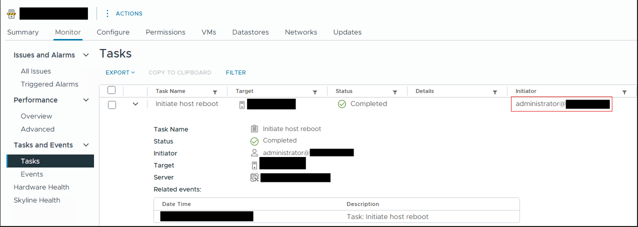

User initiated - CLI, UI, DCUI, IPMI, etc.
To confirm a reboot/restart was user initiated with the vSphere client follow the steps below
    • Login to the vSphere Client
    • Select the host the rebooted
    • Select Monitor
    • Select Tasks
This information can also be found in the ESXi logs in /var/log/hostd.log:
[YYYY-MM-DDTHH:MM:SS] In(###) Hostd[######]: [Originator@#### sub=Vimsvc.TaskManager opID=####-####:####-#### sid=######## user=vpxuser:####-####] Task Created : haTask-ha-host-vim.HostSystem.reboot-##########
[YYYY-MM-DDTHH:MM:SS] In(###) Hostd[######]: -->    eventTypeId = "esx.audit.hostd.host.reboot.reason",
[YYYY-MM-DDTHH:MM:SS] In(###) Hostd[######]: -->          value = "The host is being rebooted through hostd."
[YYYY-MM-DDTHH:MM:SS] In(###) Hostd[######]: [Originator@#### sub=Vimsvc.ha-eventmgr] Event 7142 : The host is being rebooted through hostd. Reason for reboot: The host is being rebooted through hostd., User: vpxuser:<vCenter admin user>.

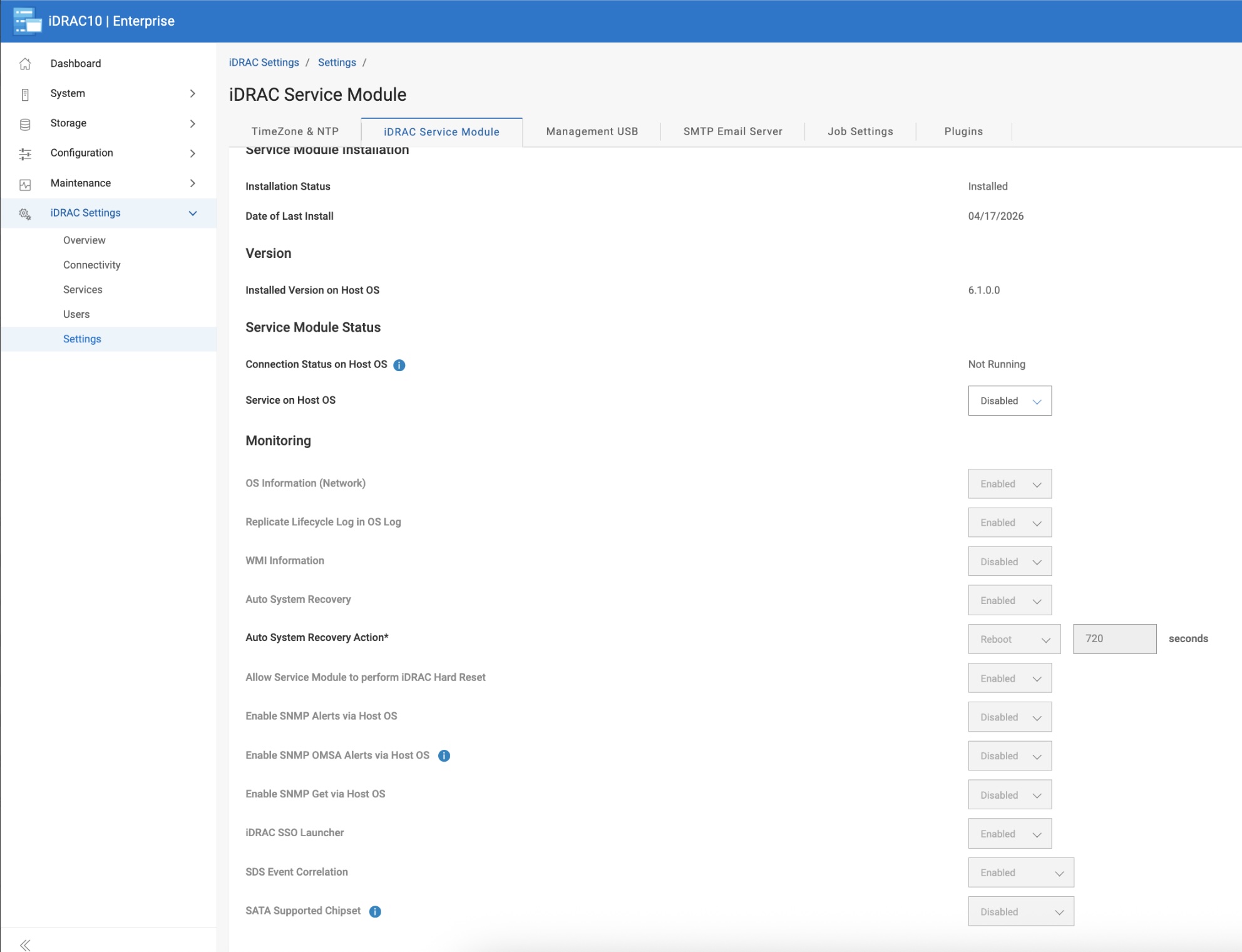

Automated Server Recovery (ASR) is a Server BIOS setting that can be enabled to reboot ESXi when there is an issue detected (unresponsive OS, hardware malfunctioning, etc..)
If this setting is enabled, a PSOD will not be generated on ESXi host as it requires time to write to disk.
It is recommended to leave the host in an unresponsive state for debugging purposes.
To leave the ESXi host in an unresponsive state ASR should be disabled. Read more at  HP Server settings for ASR  & DELL Server settings for ASR
Steps to disable ASR in DELL iDRAC (Check with Dell for latest steps on this procedure) :
  • Log on to the iDRAC with the Admin account
  • Click on "iDRAC Settings" tab
  • Click on the "Services" tab
  • Go to Automated System Recovery Agent
  • Change the settings to "Disable"
