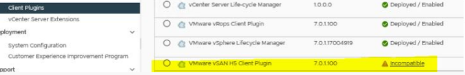

  • Ensure that the vSAN plugin is displaying as Green Deployed/Enabled in the vCenter Administrator---> client plugins.
  • If the vSAN client plugin shows an incompatible/failed/disabled status, the vSAN configuration option may not be visible in the vCenter GUI at the cluster level.

  • At times, a plugin may appear as incompatible as shown in the screenshot below.

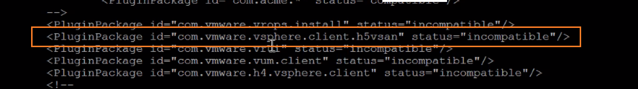

  • Validate the content of the file : /etc/vmware/vsphere-ui/compatibility-matrix.xml  on the vCenter  ( take a root login through the putty session)
  • Make sure that the status is not marked as incompatible ( marked in the orange box below ).
  • If the status is listed as incompatible, then proceed to remove the specific entry from the file, ensuring to take a backup of the file in safe location.
