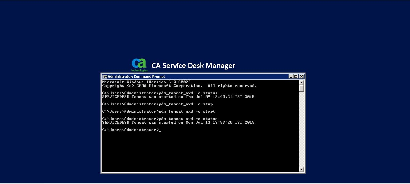

  1. Save the modified WEB.XML file and restart the Tomcat process.
