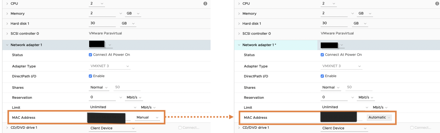

1. For Migrated Virtual Machines on VMC
Change MAC Address Setting from Manual to Automatic
  • Step 1: Power Off the VM
    • Before making changes to the MAC address settings, ensure that the VM is powered off to avoid any disruptions.
  • Step 2: Access VM Settings
    • Navigate to the settings of the affected VM within the VMC environment.
  • Step 3: Modify Network Adapter Settings
    • Locate the network adapter settings and change the MAC address option from Manual to Automatic. This allows VMware to assign a unique MAC address during the cloning process.
  • Step 4: Power On the VM
    • After making the changes, power the VM back on to apply the new settings.
