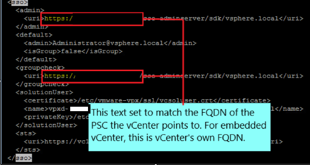

    • Ensure all uri tags in the <sso> area point to the correct Platform Services Controller FQDN.
      • If this is a vCenter with an embedded PSC then this information will still be the vCenter's FQDN.
