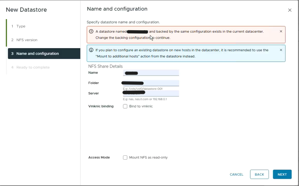

    • After unmounting an inaccessible datastore from the hosts, attempts to remount the datastore on the same host fails with the error: A datastore named "datastore_name" and backed by the same configuration exists in the current datacenter. Change the backing configuration to continue.

  • This is a rare scenario that could manifest when the datastore is mounted using the original LUN in 1 of the datacenter and as a replica LUN/snapshot in another datacenter belonging to the same or a different vCenter. Also such a problem is mostly seen in very large infrastructures and very uncommon in smaller vSphere environments.
  • This issue may also occur as a symptom of the same reason described above manifesting itself as a duplicate UUID belonging to the same datastore in the vCenter database.
  • Additionally, when a datastore is removed from vCenter inventory and is no longer visible but you hit this error, it must be removed from the vCenter database.
