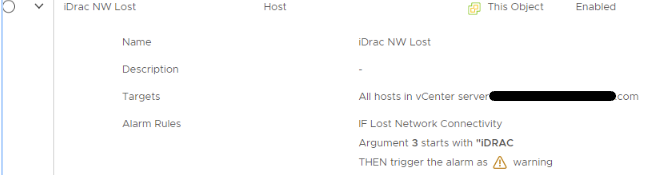

To trigger this alarm correctly, you should modify the Alarm to use "Argument 3" instead of net.name (Network Name)
Note: Argument 1 maps to the vSwitch or vDS, Argument 2 maps to the vmnic and Argument 3 maps to the PortGroup(s)
Also note that  the Port Group Name  or vSwitch name has to begin with a double-quote, for e.g. "iDRAC, for it to match the Event Spec generated.
