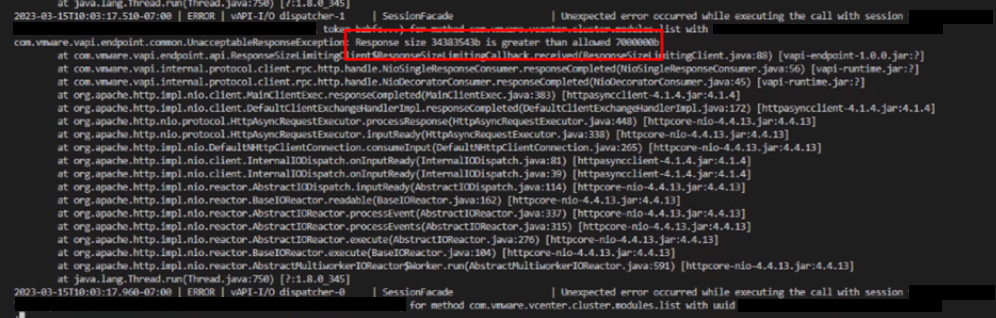

vapi-endpoint service will fail to start or crash with this error.
VMware vCenter Server 7.0.x
VMware vCenter Server 8.0.x
There is a filter being hit. The response is too big. This filter is there to guard against the vapi-endpoint being taken down accidentally by a very big response sent by the upstream vapi provider.
