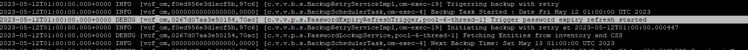

Check sddc manager operationsmanager.log sand confirm you see the cron job triggered
