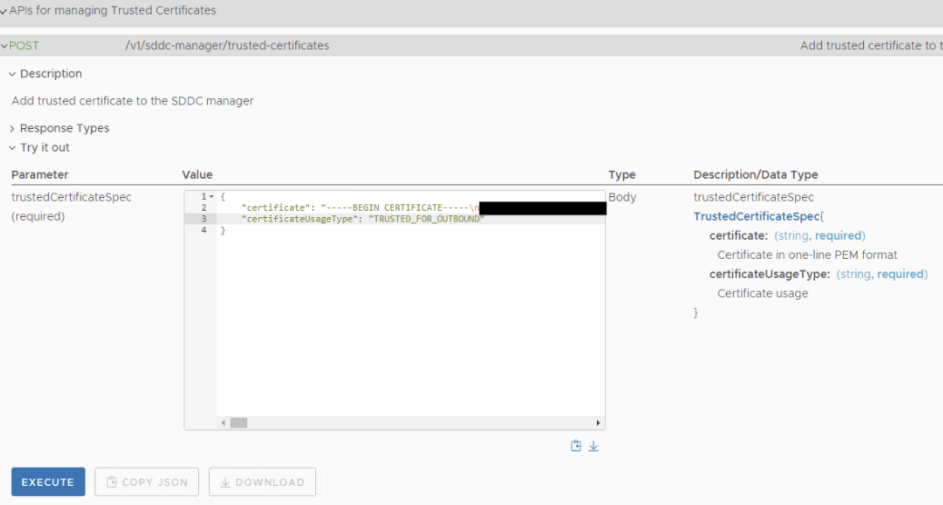

Workaround
If the SDDC UI is accessible, you can also import the root certificate from API Explorer.
  1. Convert the root certificate on the vCenter into single-line PEM format and copy the output.
    awk 'NF {sub(//, ""); printf "%s\\n",$0;}' /tmp/vmca.crt
    For example:
    root@vcenter-1 [ ~ ]# awk 'NF {sub(//, ""); printf "%s\\n",$0;}' /tmp/vmca.crt
    -----BEGIN CERTIFICATE-----
    <certicate..............>
    -----END CERTIFICATE-----\n
  2. Navigate to the API Explorer in the SDDC UI and input the certificate and certificateUsageType.
    API Explorer > APIs for managing Trusted Certificates > POST
    • Input the certificate in one line PEM format in the certificate field.
    • Input TRUSTED_FOR_OUTBOUND into the certificateUsageType field.
  3. Click Execute.
