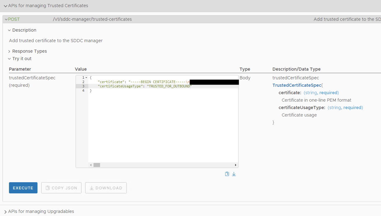

    2. UI Method using API Explorer (In case SDDC Manager UI is accessible):
      1. Convert the root certificate on the vCenter into single-line PEM format and copy the output.
        awk 'NF {sub(//, ""); printf "%s\\n",$0;}' /tmp/vmca.crt
        For example:
        root@vcenter-1 [ ~ ]# awk 'NF {sub(//, ""); printf "%s\\n",$0;}' /tmp/vmca.crt
        -----BEGIN CERTIFICATE-----
        <certificate..............>
        -----END CERTIFICATE-----\n
      2. Navigate to the API Explorer > APIs for managing Trusted Certificates > POST and input the certificate and certificateUsageType.
        Input the certificate in one line PEM format in the certificate field.
        Input TRUSTED_FOR_OUTBOUND into the certificateUsageType field.
      3. Click EXECUTE
