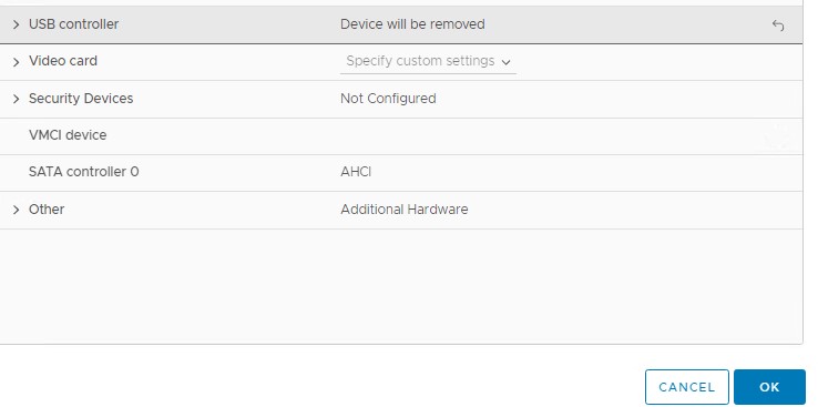

Using the vSphere Client (UI)
1) Ensure that the USB controller is not in use
2) Power off the Virtual machine (If required - No requirement to power off if the guestOS supports hot removal"
3) Right-click the virtual machine and click "Edit Settings".
4) Remove all controllers from the VM.
5) Click "OK" to apply the new virtual machine configuration.
