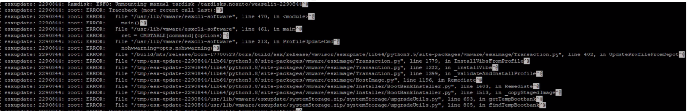

During the upgrade process from ESXi 6.7.0 to ESXi 7.0.3, several errors were encountered.
  • From the ILO:
  • From the Lifecycle Manager:
  • From the command line:
VMware vSphere ESXi 7.0
The creation of the OS Data VMFS datastore was hindered by the presence of a local datastore on the boot device. This resulted in the failure to create the temporary bootbank directory.
  • The faulty ESXi hosts were unable to create the temporary bootbank directory due to a conflict with the local datastore (VMFS 0). The local datastore, residing on the boot device, occupied the partition space, preventing the creation of the necessary OS Data VMFS datastore.
