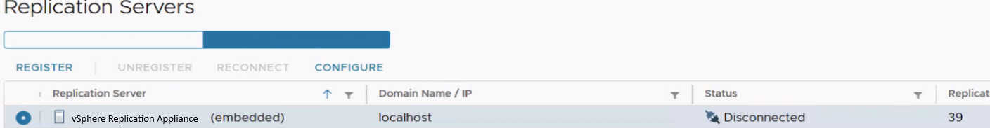

  • vSphere Replication shows as disconnected in Site Recovery UI
  • Reconnecting it throws the error:
ERROR
Operation Failed
Cannot establish a TCP connection to server at '10.X.X.X:8123'. Details: 'https://10.X.X.X:8123 invocation failed with "org.apache.http.conn.HttpHostConnectException: Connect to 10.##.##.##:8123 [/10.X.X.X] failed: Connection refused (Connection refused)"'.
