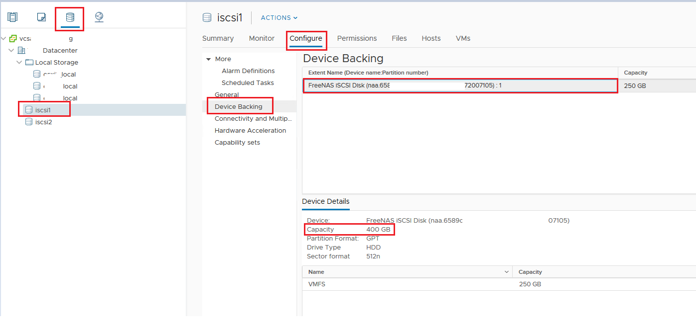

  1. From the Web Client, right click the ESXi host and select Storage > Rescan Storage. This forces the ESXi host to sync with the changes on the underlying expanded devices.
  2. Once the rescan storage completes, navigate to the Datastore View and select the datastore to be expanded.
  3. Navigate to Configure > Device Backing and select Extent Name. You should see the Device Details reflecting the updated capacity from the expansion that was done from the SAN.
    Note: In this example, the datastore iscsi1 was configured for 250 GB and the underlying device was expanded to 400 GB.
If the underlying device does not reflect the underlying information, attempt another host level rescan so that the fields highlighted in the image above indicate the desired change. Only follow these steps if the increase in the capacity of the underlying device is detected:

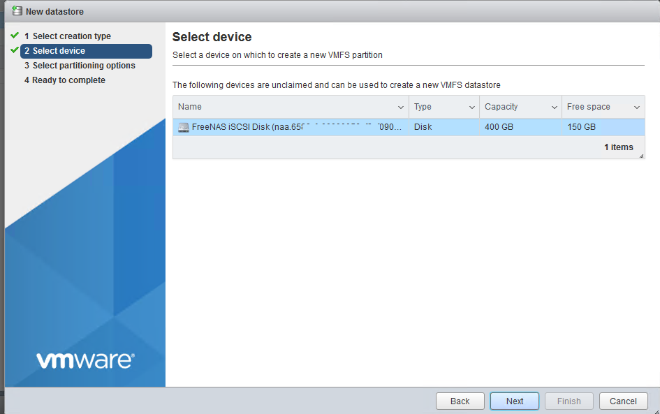

    1. Right-click on the datastore and select Increase Capacity. Alternatively, select the Increase capacity button.
      You should be prompted to select one of two options:
      Add an extent to existing VMFS datastore
      Expand an existing VMFS datastore extent
      Note: The first option is to create a multi-extent datastores by spanning (adding) a new volume to the existing datastore. The second option is to increase the capacity for the existing device itself. In this example, the second option is used:
  3. Select the VMFS partition as highlighted in the image and use the side-scroller to indicate the range of the expansion that would need to be done and click Next.
