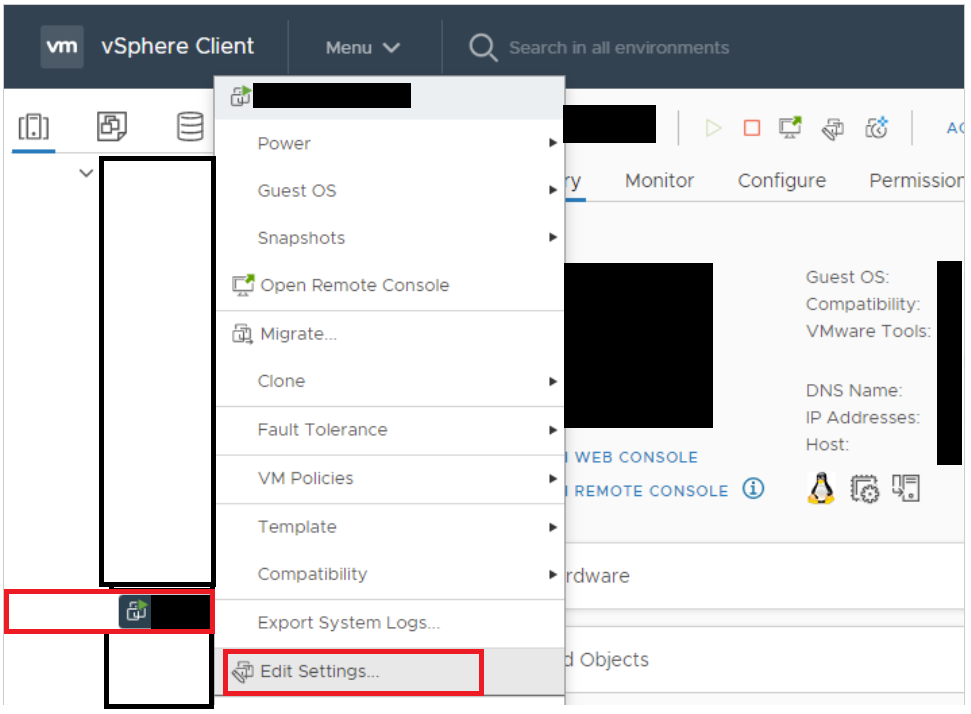

Via the vSphere Client: Process to correct the size information in the VM Descriptor file and in the VM settings:
1.) Shut down the VM(s) which have the affected RDM Disk attached

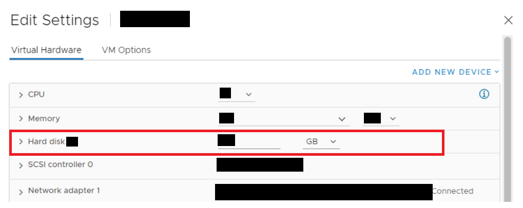

2.) For all affected VMs: Open the VM Settings

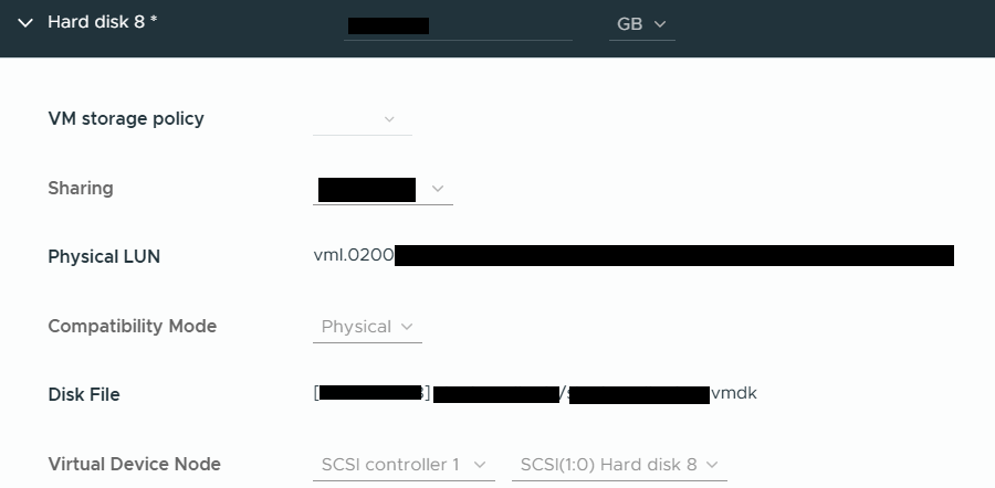

2.) Document RDM disk settings (multi-writer mode/physical mode type/etc.) along with the RDM SCSI controller settings (SCSI ID)
3.) For all affected VMs: Remove the RDM from all of the connected VMs (DO NOT DELETE THE DISK)
4.) For all affected VMs: Re-add the RDM back using the original SCSI controller and disk configuration that was documented before the disk was removed
5.) Power on all affected VMs by "One-By-One" and verify that the RDM Disk is now showing the correct size via the VM Settings
