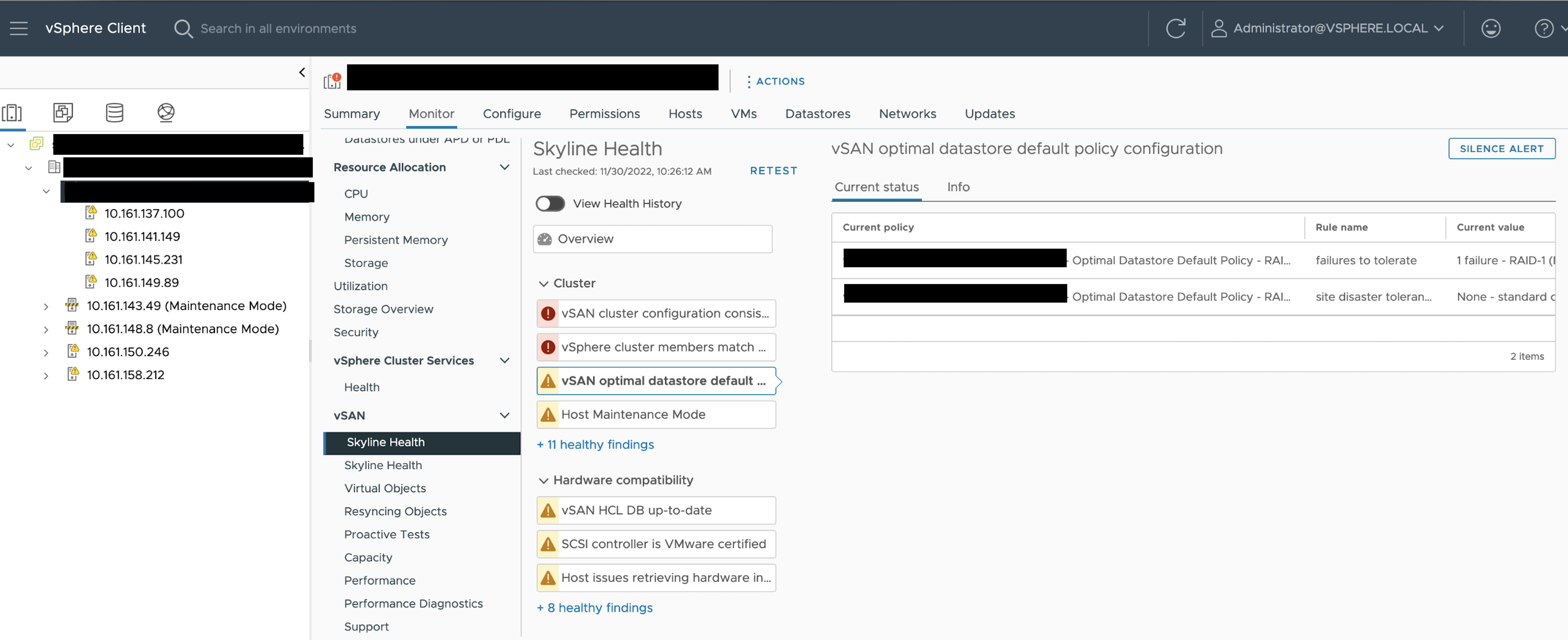

Q: What does it mean when it is in a warning state?
When in a warning state, it means that the cluster's current datastore policy is not optimal.  The test table has five columns: policy name | rule name | current value | suggested value| status.  The table has two rows: 1st row is for "Failure to tolerate" rule and 2nd row is for "Site disaster tolerance" rule.  Any row's status in a warning state means the current rule value does not match the suggested rule value.
Q: How does one troubleshoot and fix the error state?
One should go to "Policies and Profiles", select "VM Storage Policy" and click the policy name in the health test table. Then edit the "Failure to tolerate" rule or "Site disaster tolerance" rule using the suggested value shown in the health test table.
