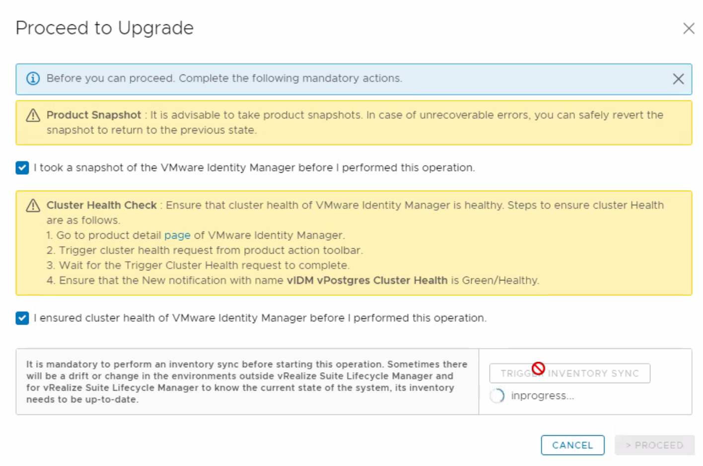

  • After initiating vIDM upgrade, an issue is encountered after triggering an Inventory sync, which is part of the Upgrade workflow.
  • Instead of receiving "Completed" banner and enabling the "Proceed" button, we see the following error:
  • Expanding the log via the Show more... button, we see the following log:
