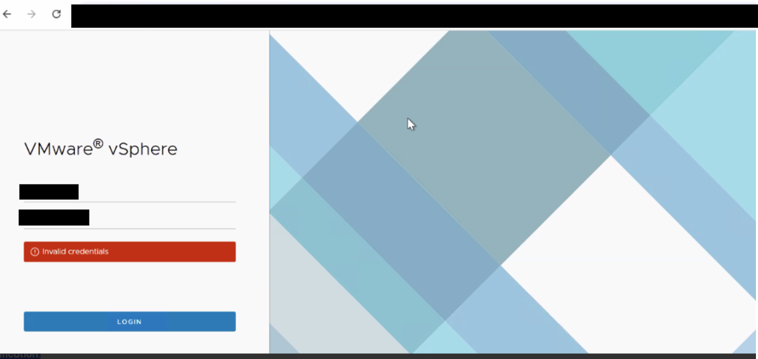

Logging in to the vCenter Server Appliance fails with the error: Failed to authenticate user

  • Logging in to the vCenter Server Appliance Web Client  fails with the error:
