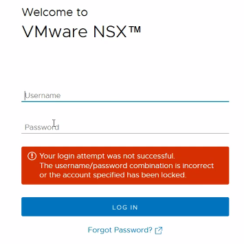

Symptoms:
Unable to login to NSX manager using AD account credentials gives an error "Can't connect to LDAP server" and also receive username/password combination incorrect if try to use different username formats.
Similar Log entries would be found when customer tries to Log in:
<99>1 2022-10-03T05:27:58.598Z NSX-Manager-1 java - - - pam_listfile(nsx-local-pam:auth): Refused user internal\user for service nsx-local-pam2022-10-03
<99>1 2022-10-03T05:27:58.235Z NSX-Manager-1 NSX 4010 SYSTEM [nsx@6876 audit="true" comp="nsx-manager" level="INFO" subcomp="http"] UserName="internal\user@10.224.7.99", ModuleName="ACCESS_CONTROL", Operation="LOGIN", Operation status="failure"2022-10-03
10:57:52.660 +0530
It is a known issue in the 1.20 SDDC version
It is a known issue in the v1.20.x  release and will be fixed in 1.22.x release.
