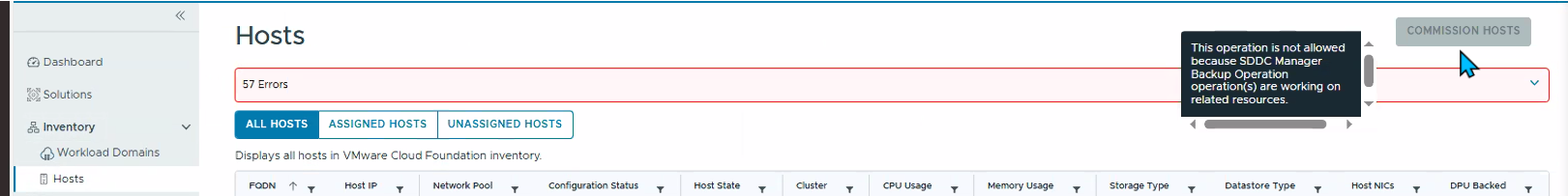

3. In some instances the "Commission hosts" option also gets greyed out in the SDDC manager UI :
