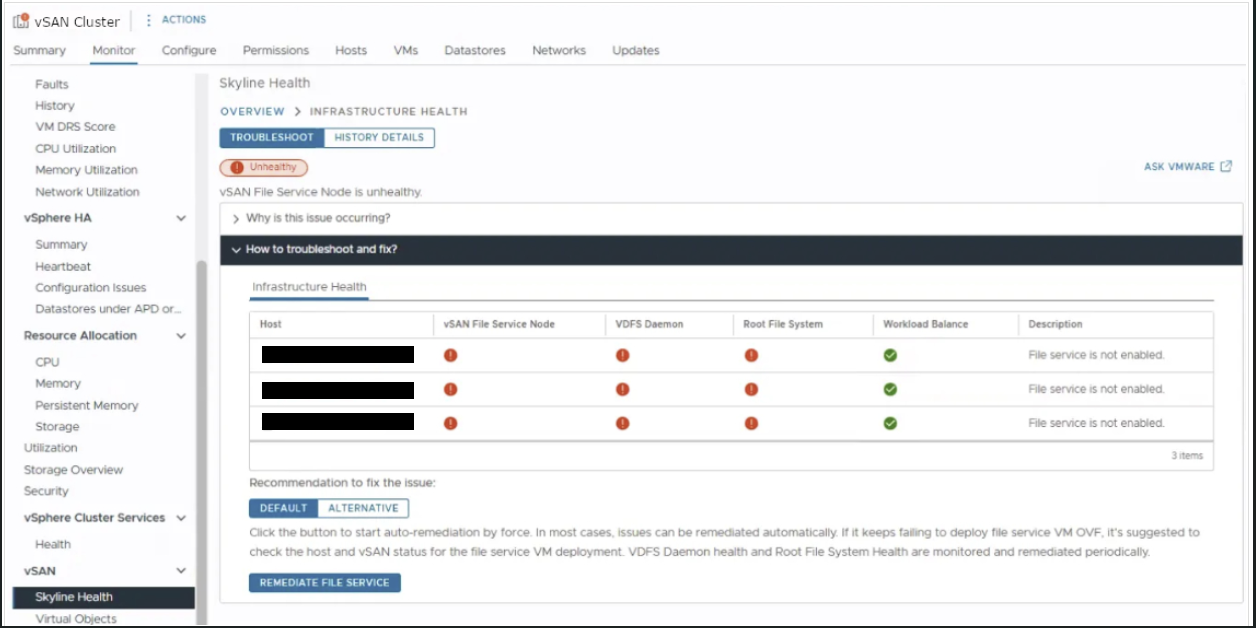

  • In the skyline health we see "Infrastructure Health" alert -
    Steps: Click on the vSAN cluster > Monitor > Under vSAN, go to Skyline Health.
  • Remediate task for "Infrastructure Health" fails with  "Cannot complete the operation. See the event log for details. Unable to enable the vSAN file service: FSVM does not exist from the beginning."
