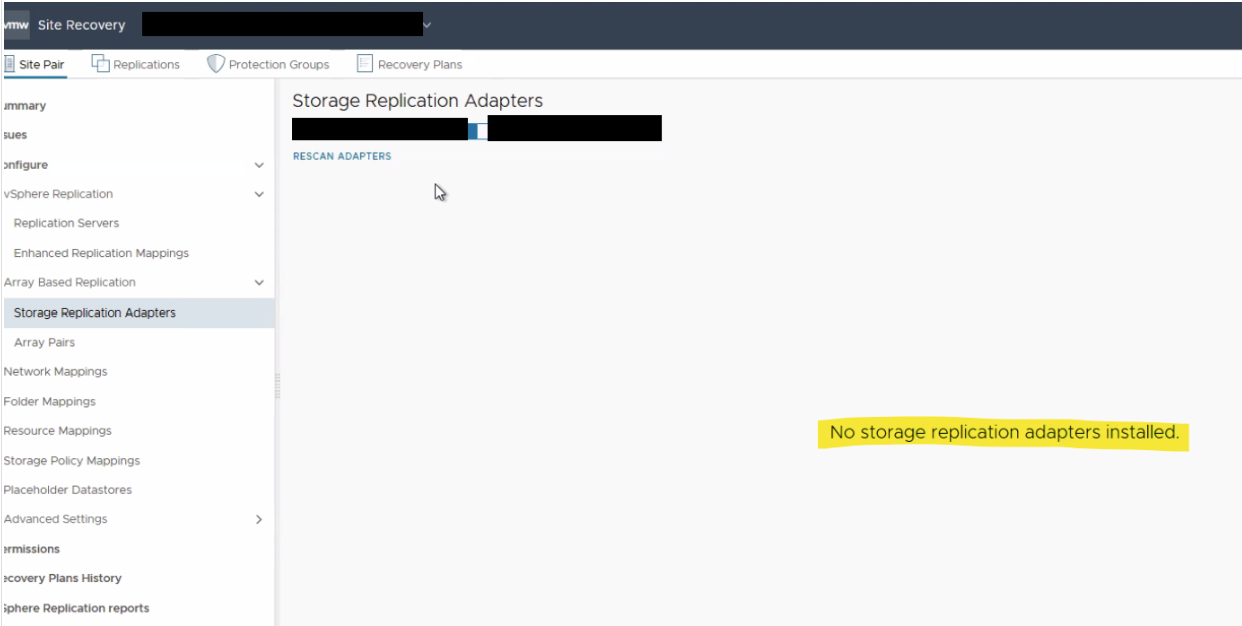

You may encounter the following error when accessing the Site Recovery Manager (SRM) user interface: Unable to retrieve pairs from extension server at https://####srm01.##.##.###:443/drserver/vcdr/vmomi/sdk.Unable to connect to Site Recovery Manager Server at https://###srm01.####.###.####:443/drserver/vcdr/vmomi/sdk. Reason: Unexpected status code: 503
This issue may occur if you are trying to add another SRA adapter to the existing SRM setup.
SRA might display errors in UI, "Unable to find SRA at the paired site", "Unable to find SRA with UUID"
