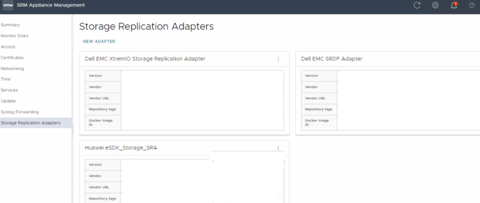

  • This issue may also occur when trying to add new or another SRA adapter to the existing SRM setup and the new SRA adapter fails to show.
