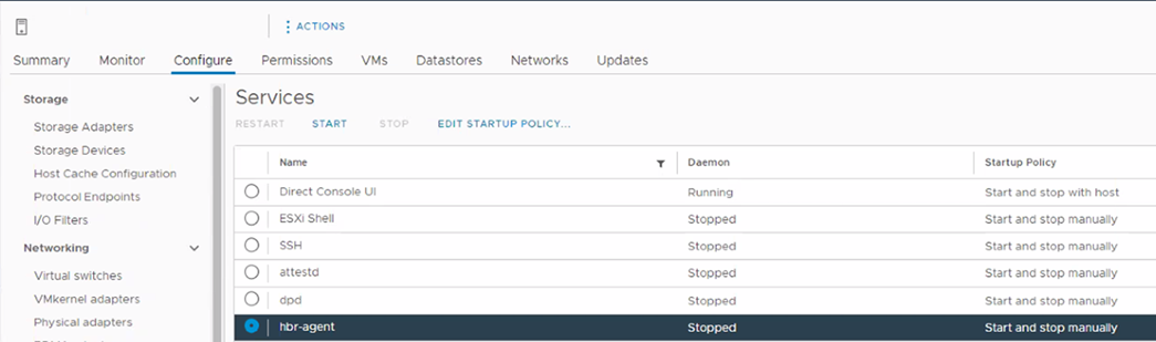

less hbr-agent.log | grep -i 'Create login request for user local-root' (In the ESXi host)
<YYYY-MM-DD>T<time> In(166) hbr-agent-bin[1060145]: <YYYY-MM-DD>T<time> hbr-agent-bin [1060145] [0x000000d5254da700] trace: [HostdVmomiHttp] Create login request for user local-root<YYYY-MM-DD>T<time> In(166) hbr-agent-bin[1060145]: <YYYY-MM-DD>T<time> hbr-agent-bin [1060145] [0x000000d525459700] trace: [HostdVmomiHttp] Create login request for user local-root<YYYY-MM-DD>T<time> In(166) hbr-agent-bin[1060145]: <YYYY-MM-DD>T<time> hbr-agent-bin [1060145] [0x000000d525459700] trace: [HostdVmomiHttp] Create login request for user local-root<YYYY-MM-DD>T<time> In(166) hbr-agent-bin[1060145]: <YYYY-MM-DD>T<time> hbr-agent-bin [1060145] [0x000000d525459700] trace: [HostdVmomiHttp] Create login request for user local-root<YYYY-MM-DD>T<time> In(166) hbr-agent-bin[1060145]: <YYYY-MM-DD>T<time> hbr-agent-bin [1060145] [0x000000d52555b700] trace: [HostdVmomiHttp] Create login request for user local-root<YYYY-MM-DD>T<time> In(166) hbr-agent-bin[1060145]: <YYYY-MM-DD>T<time> hbr-agent-bin [1060145] [0x000000d525459700] trace: [HostdVmomiHttp] Create login request for user local-root
hbr agent connects to the host repeatedly:
<YYYY-MM-DD>T<time> In(166) hbr-agent-bin[1060145]: <YYYY-MM-DD>T<time> hbr-agent-bin [1060145] [0x000000d525459700] trace: [AsyncVmomiClient] Connected<YYYY-MM-DD>T<time> In(166) hbr-agent-bin[1060145]: <YYYY-MM-DD>T<time> hbr-agent-bin [1060145] [0x000000d525459700] trace: [HostdVmomiHttp] Create acquire local ticket request<YYYY-MM-DD>T<time> In(166) hbr-agent-bin[1060145]: <YYYY-MM-DD>T<time> hbr-agent-bin [1060145] [0x000000d525459700] trace: [AsyncVmomiClient] Write request'YYYY-MM-DD>T<time> In(166) hbr-agent-bin[1060145]: <YYYY-MM-DD>T<time> hbr-agent-bin [1060145] [0x000000d525459700] trace: [AsyncVmomiClient] Read response<YYYY-MM-DD>T<time> In(166) hbr-agent-bin[1060145]: <YYYY-MM-DD>T<time> hbr-agent-bin [1060145] [0x000000d5253d8700] trace: [Http] HTTP 1/1 200 response<YYYY-MM-DD>T<time> In(166) hbr-agent-bin[1060145]: <YYYY-MM-DD>T<time> hbr-agent-bin [1060145] [0x000000d5253d8700] trace: [Http] Got 6 HTTP headers<YYYY-MM-DD>T<time> In(166) hbr-agent-bin[1060145]: <YYYY-MM-DD>T<time> hbr-agent-bin [1060145] [0x000000d5253d8700] trace: [Http] Content length: 558<YYYY-MM-DD>T<time> In(166) hbr-agent-bin[1060145]: <YYYY-MM-DD>T<time> hbr-agent-bin [1060145] [0x000000d5253d8700] trace: [AsyncVmomiClient] Transfer content: 0 bytes (558already in buffer)<YYYY-MM-DD>T<time> In(166) hbr-agent-bin[1060145]: <YYYY-MM-DD>T<time> hbr-agent-bin [1060145] [0x000000d5253d8700] debug: [AsyncVmomiClient] Acquired local ticket, loggingin ...<YYYY-MM-DD>T<time> In(166) hbr-agent-bin[1060145]: <YYYY-MM-DD>T<time> hbr-agent-bin [1060145] [0x000000d5253d8700] trace: [HostdVmomiHttp] Create login request for user local-root<YYYY-MM-DD>T<time> In(166) hbr-agent-bin[1060145]: <YYYY-MM-DD>T<time> hbr-agent-bin [1060145] [0x000000d5253d8700] trace: [AsyncVmomiClient] Write request<YYYY-MM-DD>T<time> In(166) hbr-agent-bin[1060145]: <YYYY-MM-DD>T<time> hbr-agent-bin [1060145] [0x000000d5253d8700] trace: [AsyncVmomiClient] Read response<YYYY-MM-DD>T<time> In(166) hbr-agent-bin[1060145]: <YYYY-MM-DD>T<time> hbr-agent-bin [1060145] [0x000000d52555b700] error: [Http] Unexpected HTTP status code: 500<YYYY-MM-DD>T<time> In(166) hbr-agent-bin[1060145]: <YYYY-MM-DD>T<time> hbr-agent-bin [1060145] [0x000000d52555b700] trace: [AsyncVmomiClient] Close connection<YYYY-MM-DD>T<time> In(166) hbr-agent-bin[1060145]: <YYYY-MM-DD>T<time> hbr-agent-bin [1060145] [0x000000d52555b700] trace: [HostdVmomiHttp] Clear session cookiesYYYY-MM-DD>T<time> In(166) hbr-agent-bin[1060145]: <YYYY-MM-DD>T<time> hbr-agent-bin [1060145] [0x000000d52555b700] trace: [AsyncVmomiClient] Connection closedYYYY-MM-DD>T<time> In(166) hbr-agent-bin[1060145]: <YYYY-MM-DD>T<time> hbr-agent-bin [1060145] [0x000000d525459700] trace: [Server] Removed 0 dead connectionsYYYY-MM-DD>T<time> In(166) hbr-agent-bin[1060145]: <YYYY-MM-DD>T<time> hbr-agent-bin [1060145] [0x000000d52555b700] trace: [AsyncVmomiClient] Connected
