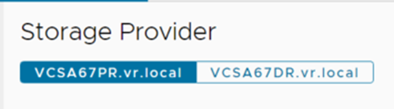

Go to SRM UI > Advanced Settings > Storage Provider
  • Configure "storageProvider.fetchDatastoreDelaySec" setting to 60 or 180 on both the vCenters (sites)
Now, you should be able to run recovery plans successfully.
