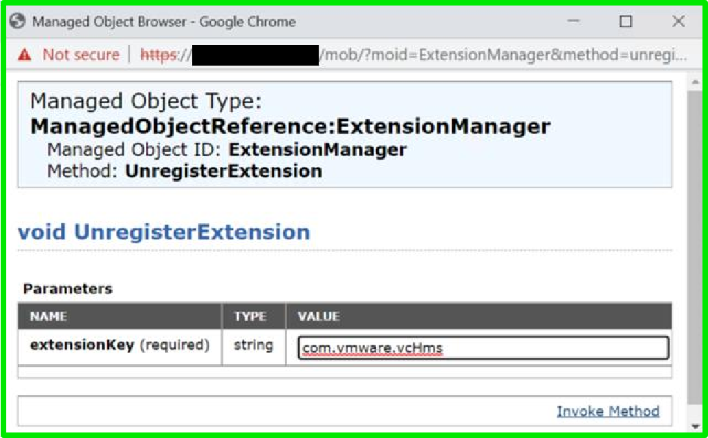

Login to vCenter MOB and remove 'com.vmware.vcHms' extension from ExtensionManager.
Open a web browser and navigate to https://<vCenter-IP-or-FQDN>/mob  >> Login with administrator@<your-sso-domain> account  >>  content  >>  ExtensionManager   >>  UnregisterExtension  >>  under 'Value' key in 'com.vmware.vcHms'  and click on Invoke Method twice.
You should now be able to register the appliance successfully.
