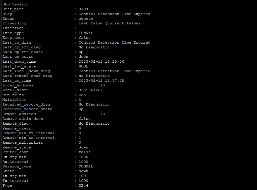

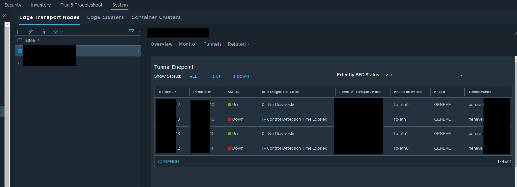

The following tunnel connectivity issues are observed and Hosts and Edge Nodes are configured to use the same VLAN for TEP traffic:
  • Tunnels between Hosts and Edge Nodes are down.
  • Tunnels between Hosts are up.
  • Tunnels between Edge Nodes are up.

  • The edge nodes have two networks that are connected to PortGroups in a VDS that are used for NSX overlay instead of a NVDS.
  • Host transport nodes and Edge nodes may be using two different TEP IP Pool, however, the backing VLAN for host TEP and edge TEP are the same.
  • In a greenfield deployment (without any running VMs on the host that uses overlay network), not all edge TEP tunnels are up.
  • In a brownfield deployment, the host TEPs to Edge TEPs are down.
  • The down TEPs have connectivity to each other within NSX edge node VRF 0 (Tunnel).
Tunnels between the edge node and prepped ESXi host will be down if the edge node's TEP interface uses a vSphere-created distributed virtual port group (DVPG) and shares the same TEP VLAN as the host.
