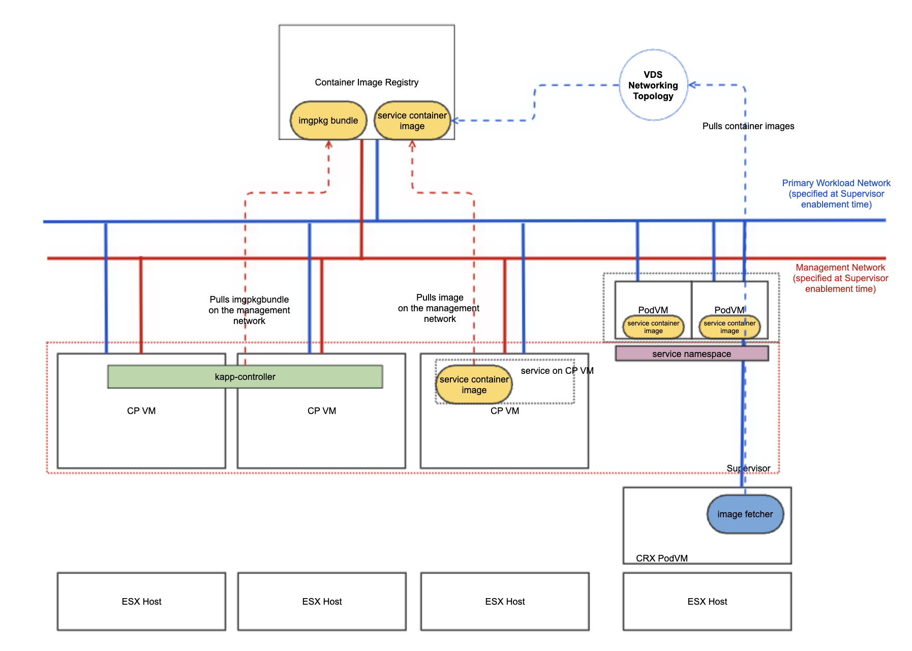

On Supervisor deployed with VDS, any UDP or TCP traffic sent from a vSphere Pod to a ClusterIP will go through the gateway of the supervisor workload network, even if the backend IP behind the Cluster IP is on the same subnetwork as the emitting vSphere Pod. There is a chance that this traffic is blocked around the gateway for the following possible reasons:
  • On the gateway, incoming UDP or TCP packets are supposed to be re-routed to the same network interface as the one from where they are coming from. This alone could be denied by security features (e.g router RPF check).
    • UDP: failure of DNS resolution at image fetching
  • While packets from pod to ClusterIP will go through the gateway, packets returning will not be able to if the pod and the backend behind the ClusterIP are on the same subnetwork. In the case of a TCP connection, it means the gateway will only see the 1st and the 3rd packets of the TCP 3-way handshake. A firewall could block this traffic.
    • TCP: failure to exchange data after TCP connection to a cluster IP from a vSphere Pod
  • The management network gateway resides on a third party router and does not allow traffic between kube-dns and the upstream DNS servers. This prevents the vSphere Pods on the ESXi host from completing a DNS lookup using Kube-DNS successfully. It is expected that KubeDNS will forward name lookups to the upstream DNS server configured in the Workload Network DNS server.
The following diagram can be used to help understand the network flow.
