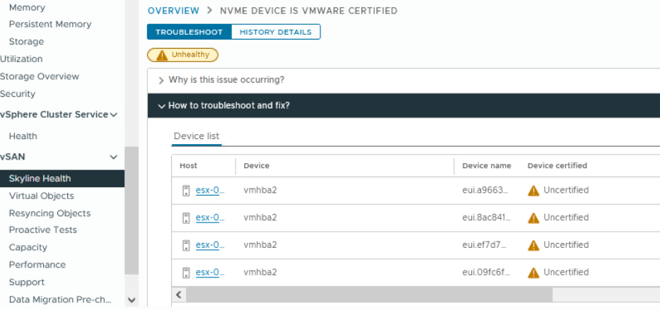

On vCenter Server 8.0, vSAN health check reports a false warning (like below) for ESX hosts with Intel VMD or any other NVMe enabled in the "Controller driver/firmware is VMware certified" check.
On vCenter Server 8.0, the cluster remediation cycle may be interrupted by vSAN health checking warning "Controller driver/firmware is VMware certified", in case the upgrading ESX host has Intel VMD or NVMe enabled controller.
Example :
In the above screenshot the Controller firmware version 52.32.3-6118 is supported as per Broadcom Compatibility Guide.

There is a regression introduced in vCenter 8.0, which causes vSAN Health Service unable to get the certified driver versions from the HCL, even though the Intel VMD controller driver / firmware is certified to use with vSAN.
The issue will be fixed in the future releases.
Workaround:
User can silence the "Controller driver/Firmware is VMware certified" health check to unblock the remediation process.
Note: This is not only related to the Intel VMD controllers but also to Samsung or any NVMe enabled controller. The driver and firmware were compatible with the 8.0U2, but still, it is reporting the warning.
